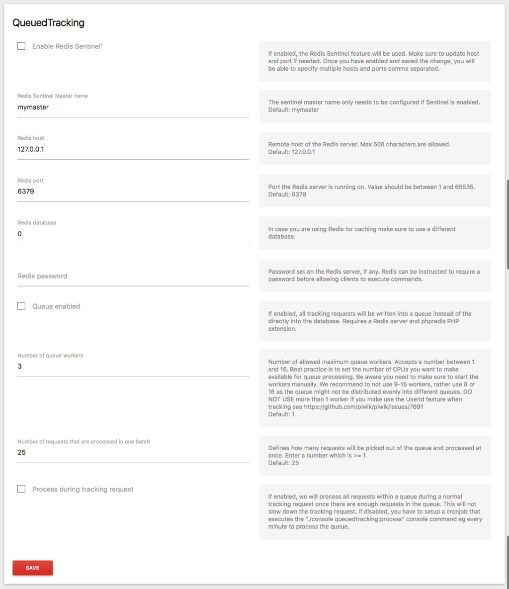

In your Matomo instance go to "Administration => General Settings". There is a config section for this plugin.

Yes, you can by adding more workers. By default only one worker is activated at a time and only one worker processes tracking requests from Redis to the database. When inserting tracking requests into the database, at time of writing this, about 80% of the time is spent in PHP and the database might be rather bored. If you have multiple CPUs available on your server you can add more workers. You can do this by going in the Matomo Admin interface to "Plugin Settings". There will be a setting "Number of queue workers". Increase this number to the number of CPUs you want to dedeciate for processing requests. Best practice is to add more workers step by step. So first increase this number to 2 and check if the tracking request insertions is fast enough for you. If not and you have more CPUs available, increase the number again.
When using multiple workers it might be worth to lower the number of "Number of requests to process" to eg 15 in "Plugin Settings". By default 25 requests are inserted in one step by using transactions. This means different workers might have to wait for each other. By lowering that number each worker will block the DB for less time.
If you process requests from the command line via ./console queuedtracking:process make sure to always start enough workers. Each time you execute this command one worker will be started. If already enough workers are in process no new worker will be started and the command just finishes immediately.

You might want to disable the queue at some point but there are still some pending requests in the queue. We recommend to
change the "Number of requests to process" in plugin settings to "1" and process all requests using the command
./console queuedtracking:process shortly before disabling the queue and directly afterwards. It is still possible to
process remaining request once the queue is disabled but new tracking requests won't be written into the queue.
