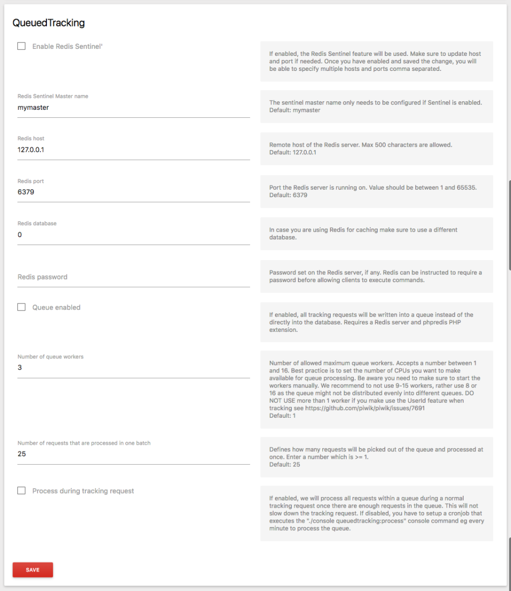

Where can I configure and enable the queue?
In your Matomo instance go to "Administration => General Settings". There is a config section for this plugin.

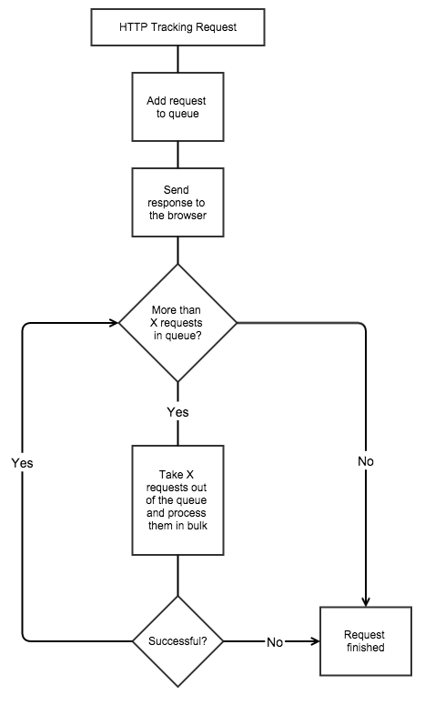

When will a queued tracking request be processed?
First you should know that multiple tracking requests will be inserted into the database at once using bulk tracking as soon as a configurable number of requests is queued. By default we will check whether enough requests are queued during a regular tracking request and start processing them right after sending a response to the browser to make sure a user won't have to wait until the queue has finished to process all requests. Have a look at this graph to see how it works:
