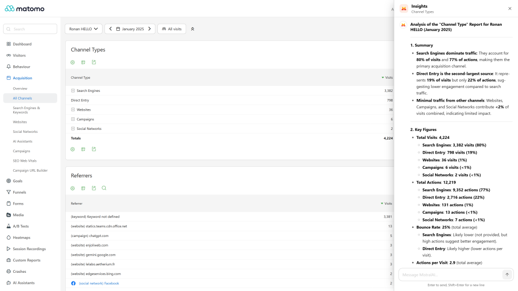

Insights on any report
  • A square AI button, styled like the Matomo 5 selectors, in the header of each report opens an insight panel that analyses the report you are looking at, then lets you ask follow-up questions.
  • The whole report is analysed as Matomo serves it, not only the visible rows: a compact payload with the rows, the totals, the metric names and units, and the exact API request behind the report.
  • The analysis follows what you see: the active segment, the period and the compared periods or segments.
  • Works with tables, evolution graphs, goals, custom reports and the other widgets backed by a Matomo report.
  • When a widget cannot be analysed, the panel shows a clear message instead of a raw error.
  • The panel is an accessible dialog: keyboard navigation, focus kept inside the panel, Escape to close.

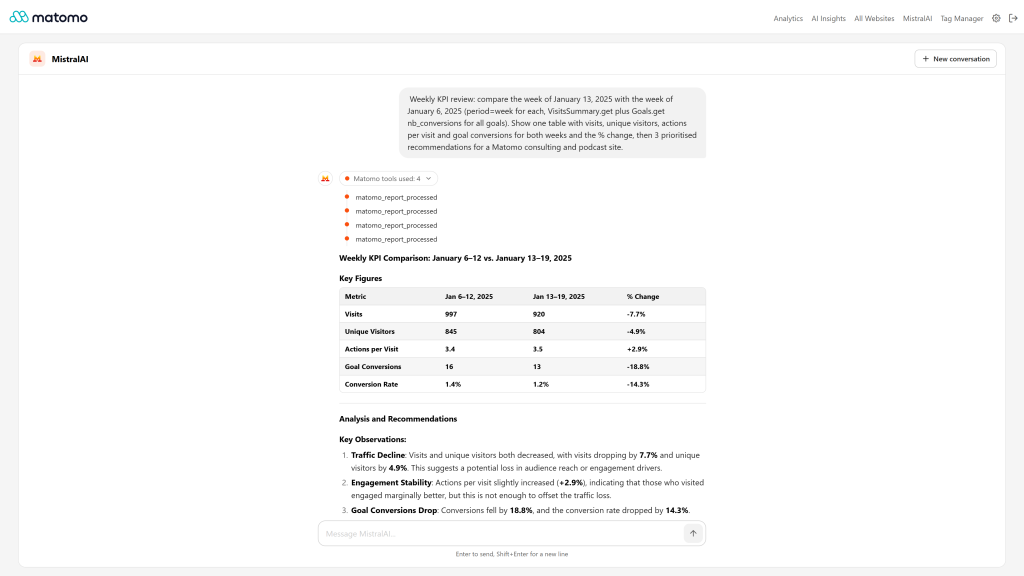

Agent mode, with MCP Server
When the MCP Server plugin, available on the Matomo Marketplace, is installed, activated and enabled, the chat and the insights switch to agent mode:
  • The assistant queries your real reports through the Matomo tools to answer, for example to compare periods or fetch a subtable.
  • Each tool call is listed in a step timeline under the answer.
  • Tools run inside Matomo with the access of the current user: no public URL, OAuth client or extra token is needed.
  • Write actions, such as creating a goal or an annotation, are only available when write mode is enabled in MCP Server. The assistant then always describes the change and waits for your explicit confirmation before it creates, modifies or deletes anything. This rule is added by the plugin and cannot be removed by editing the prompts.
  • When agent mode is not available, the chat recommends the next step: install MCP Server, activate it, enable MCP or enable write mode. Super users get a direct link, other users are asked to contact their administrator.
  • Agent mode has its own Agent mode model setting, because calling tools needs a larger model than chatting.
The agent mode is optional. Without MCP Server, the chat and the insights keep working with the plugin settings.

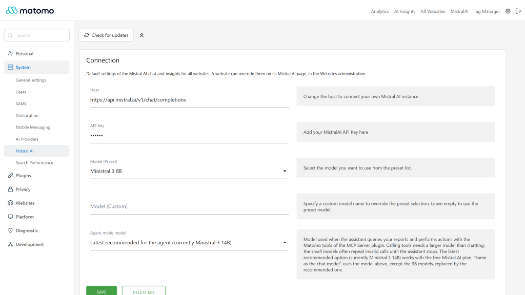

Connection and models
  • One key is enough: the key of the website is used first, then the general key. The plugin never uses the Matomo AI Providers plugin, which has no Mistral AI provider, so the credential of another provider is never sent to Mistral AI.
  • Works with Mistral AI (default) and any OpenAI-compatible chat completions endpoint served over HTTPS, including self-hosted models. The API key is optional on a custom host.
  • The general API key is only sent to the general host: a website using its own host never receives it.
  • Presets curated for conversation: Latest recommended (default, currently Ministral 3 14B), Mistral Medium 3.5, Mistral Large 3, Mistral Small 4, Ministral 3 14B, 8B and 3B. A custom model field accepts any other model name.
  • When the configured model is deprecated, retired or not included in your Mistral AI plan, the chat explains it and links to the settings instead of showing the raw API error.

Installation / Configuration
  1. Install and activate Mistral AI from Administration > Platform > Marketplace.
  2. As a super user, open Administration > System > Mistral AI:
    • Connection card: host (an HTTPS URL), API key, chat model and agent mode model. Each card is saved on its own. The saved key is never displayed, and a Delete key button removes it. Create a key in the Mistral AI console.
    • Privacy card: check Allow sending Matomo data to the AI provider, off by default. Until a super user checks it, nothing is sent to the provider. The card shows where the data goes, and masks e-mail and IP addresses, removes URL query strings and excludes visitor-level data, all three on by default.
    • Prompts card: chat and insight base prompts, with a Reset to default button.
  3. Optionally, override the settings for a website in Administration > Websites > Mistral AI (website admin access): host, API key, model and prompts, with a Delete key button and a Use the general prompts button. Empty fields use the general settings.
  4. For the agent mode, install, activate and enable MCP Server, and enable write mode in its settings if you want the assistant to perform actions. The chat guides you through each missing step.

Report insights
The square AI button in the header of each report, styled like the Matomo 5 selectors, opens an insight panel. The analysis uses the full report as Matomo serves it: a compact payload with the rows, the totals, the metric names and units, and the exact API request behind the report. The active segment, the period and the compared periods or segments are taken into account. Tables, evolution graphs, goals, custom reports and the other widgets backed by a Matomo report are supported. You can ask follow-up questions in the same panel.

The Mistral AI page of the main menu is a full chat with suggested questions. Answers stream in real time and are rendered as Markdown, with readable tables, highlighted code and copy buttons. The conversation follows the latest message while it is written, unless you scroll up.
Agent mode
With the MCP Server plugin (Matomo Marketplace) installed, activated and enabled, the assistant queries your real reports through the Matomo tools to answer. Each tool call appears in a step timeline under the answer.
  • Read tools are available as soon as MCP is enabled.
  • Write actions, such as creating a goal or an annotation, need write mode in the MCP Server settings. The assistant then always describes the change and waits for your explicit confirmation before it creates, modifies or deletes anything.
  • When a step is missing, the chat recommends it: install MCP Server, activate it, enable MCP or enable write mode. Super users get a direct link, other users are asked to contact their administrator.
  • Agent mode uses the Agent mode model of the general settings. Its default, "Latest recommended", works with the free Mistral AI plan. "Same as the chat model" reuses the chat model, except the 3B models, which are replaced by the recommended one.
Settings
General settings
Administration > System > Mistral AI (super user):
Card Setting Description Connection Host Chat completions endpoint, an HTTPS URL. Default: https://api.mistral.ai/v1/chat/completions Connection API key Required for Mistral AI, optional for a custom host. Never displayed once saved, removed with Delete key Connection Model (Preset) Latest recommended (default), Mistral Medium 3.5, Mistral Large 3, Mistral Small 4, Ministral 3 14B, 8B or 3B Connection Model (Custom) Any model name, overrides the preset Connection Agent mode model Model used with the Matomo tools Privacy Allow sending Matomo data to the AI provider Off by default: nothing is sent until a super user checks it Privacy Mask e-mail and IP addresses Replaced with [email] and [ip] before sending. On by default Privacy Remove URL query strings The parameters after the ? of the URLs are removed before sending. On by default Privacy Exclude visitor-level data Visits Log, visitor profiles, real-time and User ID reports are kept out. On by default Prompts Chat base prompt Instructions of the chat Prompts Insight base prompt Instructions of the insights
Each card is saved on its own. Reset to default fills in the default prompts in your language. A prompt equal to its default is not stored, so it follows the updates of the plugin. Default prompts saved by previous versions are upgraded automatically, custom prompts are kept.
Website settings
Administration > Websites > Mistral AI (website admin) overrides the host, API key, model and prompts for one website. Leave a field empty to use the general value. Use the general prompts makes the website follow the general prompts again.
API key cascade
The key of the website is used first, then the general key. The general key is only sent to the general host, so a website using another host must set its own key. The plugin never uses the Matomo AI Providers plugin, which has no Mistral AI provider.

What do the insights analyse?
The full report as Matomo serves it, not only the visible rows: the rows, the totals, the metric names and units, the active segment, the period and the compared periods or segments. Evolution graphs, goals and custom reports are supported. When a widget cannot be analysed, the panel shows a clear message.
