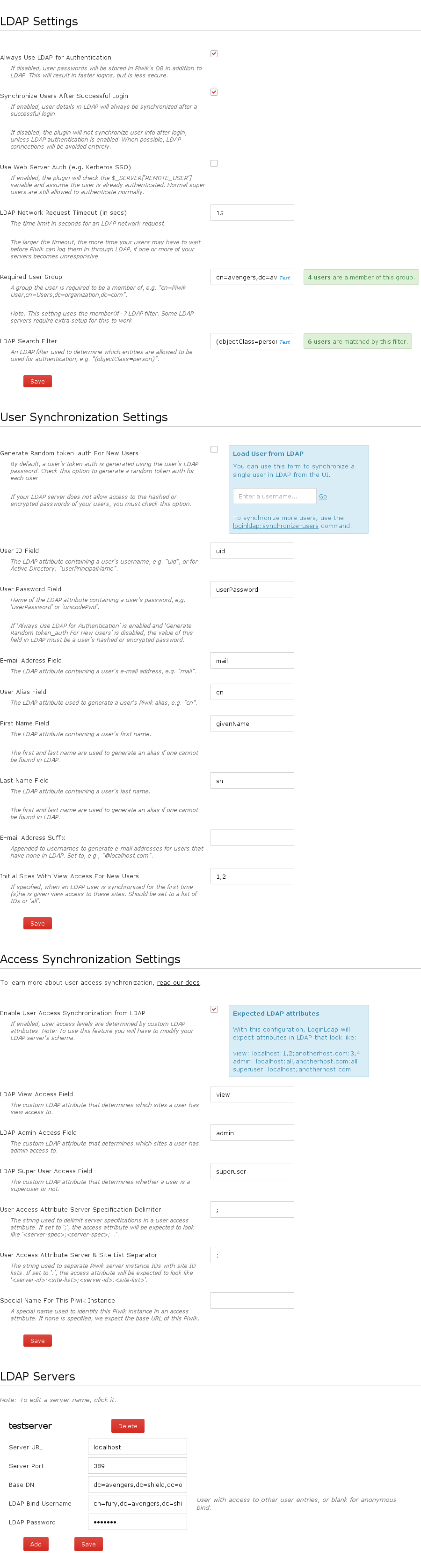

Navigate tothe Settings > LDAP admin page. If the configuration options look broken, make sure to reload your browser cache. You can do this by reloading the page, or through your browser's settings.
The admin user for servers must now be a full DN. In the LDAP settings page, change the admin name to be the full DN (ie, cn=...,dc=...).
Uncheck the Use LDAP for authentication checkbox

You can enter fallback servers by adding new servers at the bottom of the Settings > LDAP page.
You can use the Required User Group and LDAP Search Filter settings to filter LDAP entries. Users whose entries do not match these filters will not be allowed to authenticate.
Set Required User Group to the full DN of a group the user should be a member of. Note: Internally, LoginLdap will issue a query using (memberof=?)
to find users of a certain group. Your server may require additional configuration to support memberof.
Set LDAP Search Filter to an LDAP filter string to use, for example: (objectClass=person) or
(&(resMemberOf=cn=mygroup,ou=commonOU,dc=www,dc=example,dc=org)(objectclass=person)).
You can test both of these settings from within the LDAP settings page.
