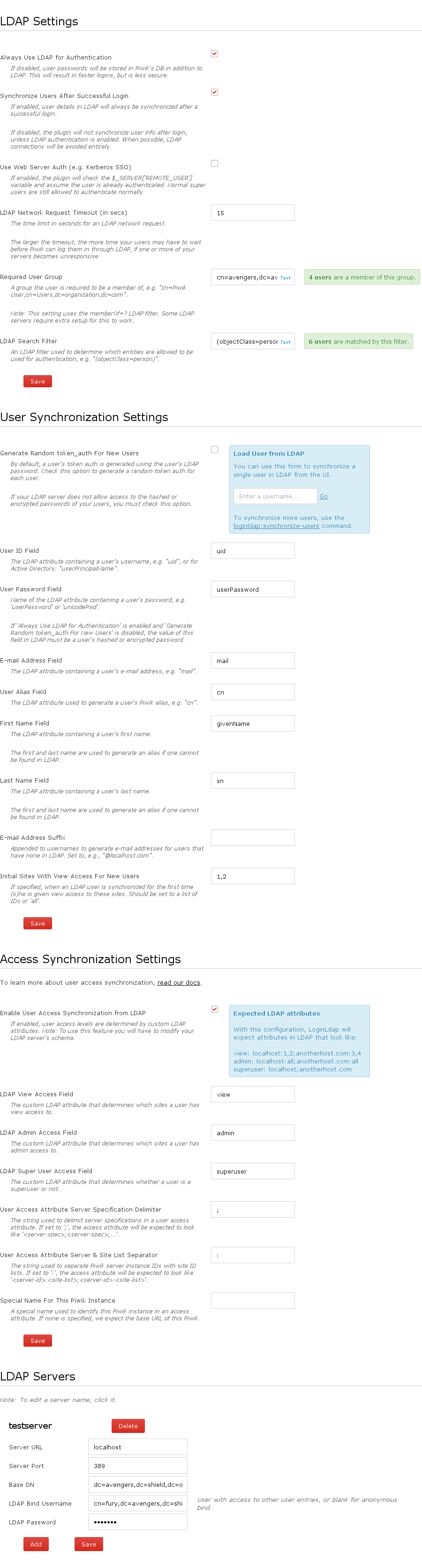

To start using LoginLdap, follow these steps:
Enter and save settings for your LDAP servers
Note: You can test your servers by entering something into the 'Required User Group' and clicking the test link that appears. An error message will display if LoginLdap cannot connect to the LDAP server.
You can now login with LDAP credentials.

Navigate tothe Settings > LDAP admin page. If the configuration options look broken, make sure to reload your browser cache. You can do this by reloading the page, or through your browser's settings.
The admin user for servers must now be a full DN. In the LDAP settings page, change the admin name to be the full DN (ie, cn=...,dc=...).
Uncheck the Use LDAP for authentication checkbox

You can use the Required User Group and LDAP Search Filter settings to filter LDAP entries. Users whose entries do not match these filters will not be allowed to authenticate.
Set Required User Group to the full DN of a group the user should be a member of. Note: Internally, LoginLdap will issue a query using (memberof=?)
to find users of a certain group. Your server may require additional configuration to support memberof.
Set LDAP Search Filter to an LDAP filter string to use, for example: (objectClass=person) or
(&(resMemberOf=cn=mygroup,ou=commonOU,dc=www,dc=example,dc=org)(objectclass=person)).
You can test both of these settings from within the LDAP settings page.
LoginLdap will use information in LDAP to determine a user's alias and email address. On the Settings > LDAP page, you can specify which LDAP attributes should be use to determine these fields.
Note: If the LDAP attribute for a user's alias is not found, the user's alias is defaulted to the first and last names of the user. On the settings page you can specify which LDAP attributes are used to determine a user's first & last name.
E-mail addresses
E-mail addresses are required for Matomo users. If your users in LDAP do not have e-mail addresses, you can set the E-mail Address Suffix setting to an e-mail address suffix, for example:
@myorganization.com
The suffix will be added to usernames to generate an e-mail address for your users.

LoginLdap also supports synchronizing access levels using attributes found in LDAP. To use this feature, first, you will need to modify your LDAP server's schema and add three special attributes to user entries:
Note: You can choose whatever names you want for these attributes. You will be able to tell LoginLdap about these names in the LDAP settings page.
Then you must set these attributes correctly within LDAP, for example:
view: alladmin: 1,2,3superuser: 1Finally, in the LDAP settings page, check the Enable User Access Synchronization from LDAP checkbox and fill out the settings that appear below it.
User access synchronization occurs at the same time as normal user synchronization. So the loginldap:synchronize-users command will synchronize access levels too.
