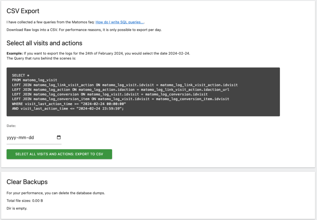

I have added some features to export raw data to a CSV file. This is useful if you want to use the data in another tool, such as Excel, Tableau, or PowerBI. This is a brand new plugin and some features are very experimental, if you have any issues, please create an issue on GitHub.

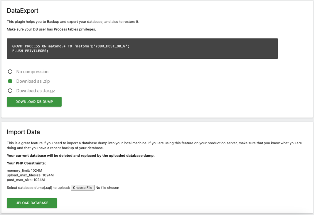

Navigate to Admin -> Platform -> Data Export and follow the instructions.
The UI is pretty straightforward. You can export the database, import a database, and export raw data to a CSV file.
I have collected a few queries from the Matomos faq: How do I write SQL queries....
$ ./console db:dump
$ ./console db:import
$ ./console db:drop
$ ./console db:create

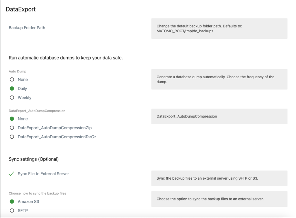

I have added an option to sync databases. This is useful if you want to sync your database to an external server or S3 bucket.
You need to configure the destination in: Admin(Cog wheel) --> System --> General settings --> Data Export
And Select the Checkbox, Sync File to External Server.
Fill in all the required settings.
Then it should sync every time a new dump is generated with the scheduled-tasks, if you have set up a ./console core:archive-job, you don't necessarily need to run it manually, It will automatically run when the core:archive process runs, one exception is if you added the --disable-scheduled-tasks flag to the command.

You can configure in the UI or add the following settings to your config.ini.php file:
[DataExport]
; dataExportBackupPath:
; Path to store the backups on the Matomo server
dataExportBackupPath = ""
; dataExportAutoDump:
; available options: "none", "daily", "weekly"
dataExportAutoDump = "none"
; dataExportAutoDumpCompression:
; available options: "none", "zip", "tar"
dataExportAutoDumpCompression = "none"
; dataExportSyncExternal:
; 1 for true, 0 for false
dataExportSyncExternal = 0
; dataExportSyncOption:
; or "sftp"
dataExportSyncOption = "s3"
; dataExportSyncFilePath:
; Path for s3 or Remote Path for sftp
dataExportSyncFilePath = ""
; dataExportSyncBucketName:
; for s3 or Hostname for sftp
dataExportSyncBucketName = ""
; dataExportSyncKey:
; Access Key for s3 or Username for sftp
dataExportSyncKey = ""
; dataExportSyncSecret:
; Secret Key for s3 or Password for sftp
dataExportSyncSecret = ""
; dataExportSyncRegion:
; Region for s3
dataExportSyncRegion = ""
Downloading files from the UI will generate a copy that stays on the server. In order to not take up too much disk space Cleanup is set to run once a day and it deletes files older than 7 days.
$ ./console scheduled-tasks:run --force "Piwik\Plugins\DataExport\Tasks.cleanBackupsFolderTask"
To manually delete all files, you can run:
$ ./console dataexport:clean-backups -f
I have started to add some API endpoints, but consider them experimental for now. CAUTION: The queries are run as live queries, so use sparingly.
You can specify the date, idSite, and format.
Example:
curl --request GET \
--url 'https://YOUR_MATOMO_URL/index.php?module=API&method=DataExport.selectAllVisitsAndActions&date=2024-02-20&idSite=1&format=json&token_auth=YOUR_ADMIN_TOKEN'
